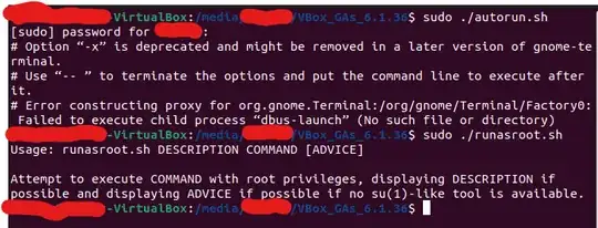

EDIT: Here is output of what first comment suggested: enter image description here

I figured it out. All I had to do was right click autorun.sh and choose Run as a program. After that terminal opened asking for sudo privileges. This worked both on minimal and full Ubuntu installs.
