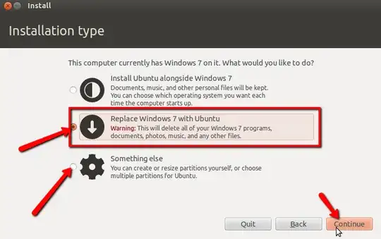

Download Ubuntu, create a bootable CD/DVD or a bootable USB flash drive. Boot form whichever one you create, and once you get to the installation type screen, choose replace Windows with Ubuntu.
If you're comfortable with dealing with partitions, then you can choose something else, delete any existing partitions, and then create a Ext4 partition mounted at / and a swap partition.

During the Ubuntu installation, you are given three options:
  1. Install Ubuntu alongside your existing Operating System(s)
  2. Erase disk and install Ubuntu
  3. Something else
In your case, you could simply select option 2, above. This would be a good option if this is your first install. It will wipe Windows and delete your data.
The third option, Something else, allows you to delete existing partitions, create new partitions, and format partitions. This could be a choice for you as well, if you want a little more control over your disk.
If you're unsure about partitioning, go with option 2.
Also, be ready for a learning curve, as with any new operating system. However, you will really appreciate being able to use your computer without the viruses.
