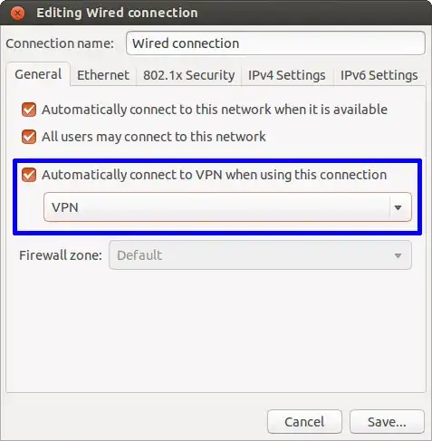

Through the Network Manager indicator nm-applet (the GNOME or Unity network tray applet installed by default), you can configure NetworkManager to automatically connect to a VPN when a network is connected.
  1. Click on the network tray applet and click "Edit connections...", or run nm-connection-editor.
  2. Select a network connection and click "Edit..."
  3. Check "Automatically connect to VPN when using this connection" and select the desired VPN in the drop-down list.
  4. Save.
nm-connection-editor screenshot
