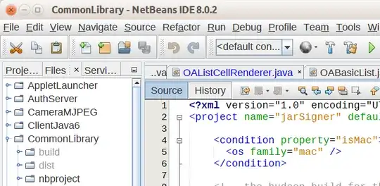

I'm having problems getting the Netbeans font to look nice, this has been a problem ever since I tried Ubuntu ~8. For some reason fonts look like they're not getting subpixel smoothing in Netbeans only, for the rest of the applications they look perfect.
Look at how ugly the screenshot is:
It's not just the code area but every font in the application looks this way. I was looking around and apparently adding the following line to the .bashrc file should fix the issue but in my case it didn't:
export _JAVA_OPTIONS='-Dawt.useSystemAAFontSettings=lcd'
It think it might only affect Java based applications, but I haven't been able to test another Java app to check the fonts out.
Does anyone know what can I do to fix this? How can I make Netbeans use the system font?

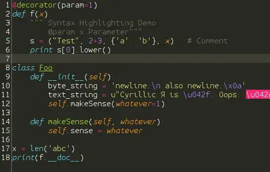

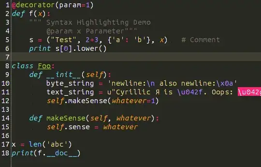

Going one step further to manual ways, I have prepared a dedicated font named as "Ubuntu Mono Nohinting" to workaround a rendering issue with Java Swing applications such as NetBeans IDE, IntelliJ IDEA and PyCharm. The font hinting information has been stripped from the original Ubuntu Mono font family.
How to install
  • download the zip file from here
  • extract it
  • open *.ttf with Font Viewer to install.
  • or you can manually copy *.ttf into ~/.local/share/fonts/.
How to use
  • Select "Ubuntu Mono Nohinting" in editors' configuration.
Screenshots
Ubuntu Mono Font with PyCharm Monokai theme
Ubuntu Mono Nohinting Font with PyCharm Monokai theme
