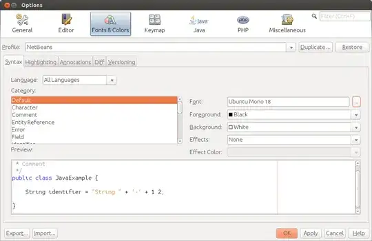

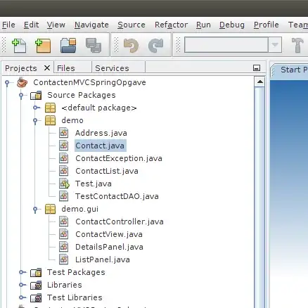

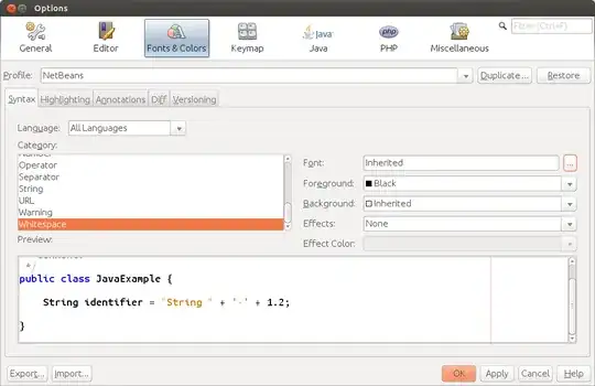

My specific question has three parts: 1) why is every font 18 or less drawing characters with lines that are only one pixel thick, and the . and : are making only one pixel on the screen - unless I force bold, or a huge font of 19 or more:
(If this is a Java problem, why is Eclipse fine?)
Bad font, thin and not easily readable Bad font, thin and not easily readable
Almost okay font - but HUGE: Almost okay font - but HUGE
If you look at the terminal or native Ubuntu apps they don't show up as only one pixel - is there a solution for this?

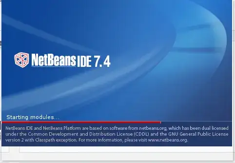

3) Maybe not related, but why do popup-windows of Netbeans have this small dropdown below them? This happens both with the netbeans-starting info window, and the git changes popouts from the bar with the line-numbers.
Ugly Netbeans dropdown

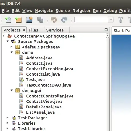

Make it use system fonts in menu and other places
This bug actually makes a lot of the text nicer in my opinion. Just sudo apt-get install fonts-unfonts-core and restart netbeans. (only works with JDK7) It will look like this:
Buggy font
However, this does not change the editor font.
Change theme
Changing the theme changes the fonts a bit, however, it does not make them thicker.
