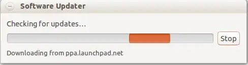

It seems that you need to update your sources, because the Update Manager is trying to fetch an older version of that flashplugin (it's trying to fetch 11.2.202.291, when 11.2.202.297 is the one found at security.ubuntu.com right now). Try following the below steps:
  1. Close your Update Manager, and open it up again. You should see something like this:
    enter image description here.
    If you do, wait for it to finish, then try updating. It should work. If not, follow the below.

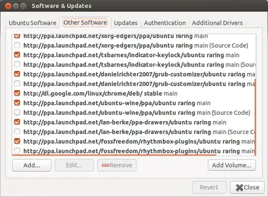

This is usually caused when the ppa locations can not be found.
To try to fix this, go to System Settings and click on the Software and Updates link
Now Click on the Other Software tab:
If you de-select ALL these locations and try update again it should work (make a note of the ones that are active first).
Once you have successfully updated the system, Start re-enabling them again, one at a time until the update fails, then you can deselect just the ones that do not work.
