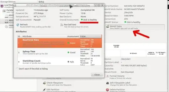

  • So first check the HDD for bad sectors. Open the Disks utility and check the S.M.A.R.T and see if disk is Healthy.
