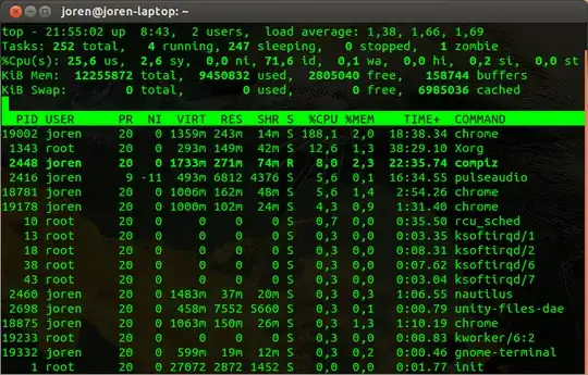

Running Flash in Google Chrome drains my CPU massively:
I figured that the cause of this issue would be that hardware acceleration of flash is turned off. When I tried turning it by right clicking a flash application and selecting settings, this window popped up:

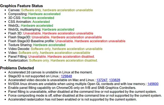

In Chrome, when I open about:gpu, I get to see this:

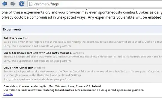

You should check your about:gpu section in Chrome/ium. In older PC's HW Acceleration is disabled by default and you only can enable it by overriding the settings in the about:flags.
  • Open the about:flags in your address bar
  • Look for Override software redendering list
  • Click "Enable"
  • Restart Chrome/ium
You can also start chrome using chrome --ignore-gpu-blacklist but having to do so each time is not ideal.
This is my GPU page
THis is my flags
