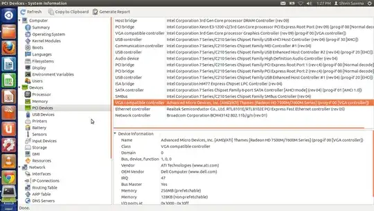

and rebooted my laptop. Still I am stuck at square one, however, my Hardware info now shows the ATI VGA driver in addition to an Intel one. Here are the names:
-PCI Devices-
VGA compatible controller : Intel Corporation 3rd Gen Core processor Graphics Controller (rev 09) (prog-if 00 [VGA controller])
VGA compatible controller : Advanced Micro Devices, Inc. [AMD/ATI] Thames [Radeon HD 7500M/7600M Series] (prog-if 00 [VGA controller])
Snapshot of PCI Devices

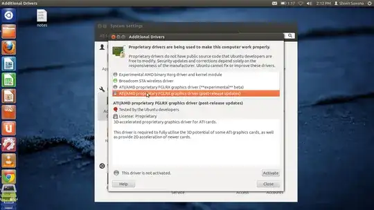

After I installed the downloaded ATI driver and checked System Settings > Additional Drivers, I see that the Raedon VGAs have been deactivated again, as shown: enter image description here

The display of the graphics card name in System Settings often does not work (just search askubuntu, there are dozens of questions about it and the answer is always the same...). I wouldn't worry about it and only trust other tools to find out which graphics driver is in use.
Your laptop obviously has a recent Intel CPU, which includes a graphics unit. This is the reason, an Intel graphics card is shown in lspci.
Your xorg.conf hints that atm you are using fglrx, and it seems to be working. To see, if the driver is really active, simply try to run fglrxinfo. Another tool that you might take a look at is amdcccle, the catalyst control center. It will give you a lot of details (if fglrx is installed).
Since you installed the driver from the AMD website, "additional drivers" will not show any driver in its list as active (since you didn't use official driver packages for Ubuntu, but the download from the AMD website).
I don't know about your laptop specifically, but you might find this guide useful: Installing Catalyst with Intel/AMD hybrid graphics
Oh, and btw, the preferred way to install the driver downloaded from the AMD website would be to make distribution specific packages and then to install those. By this, you can ensure that it stays working when you get Kernel updates. If you simply install it, it might be, that you have to reinstall it every time, a Kernel update is installed.
