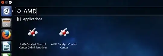

You're currently running with the open-soured AMD driver, to switch to the Intel graphic card, a safer way is to install the proprietary AMD video driver to get this feature (search "Driver" in your dash). And you will be able to use the AMD Catalyst Control Center for it, which can be found from the dash as well: dash

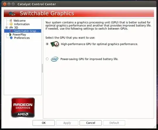

Which should allow you to switch between the Intel and the AMD GPU: AMDCCC
Note that the system must be rebooted.
