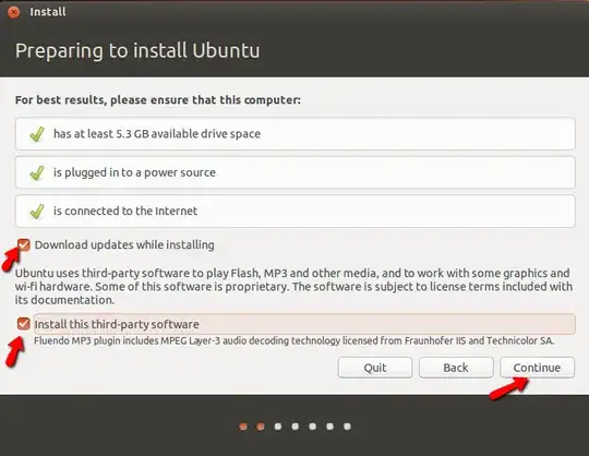

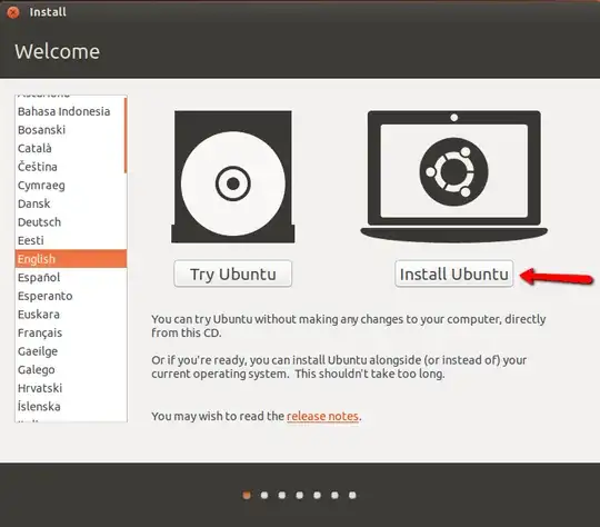

Since you have already made the bootable USB, then change First Boot Device in BIOS to Boot USB. Once the boot process starts, click on install Ubuntu

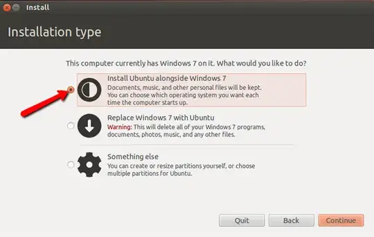

Once the installation starts, Select install Ubuntu alongside Windows 7. Click continue.
Make sure that you have the proper drive selected from the drop-down.
The right partition is where Ubuntu is going to be installed. The left partition is the Windows operating system. Drag the handle bar to re-size the Ubuntu partition. Once you have selected the the size of your Ubuntu partition click install now.
