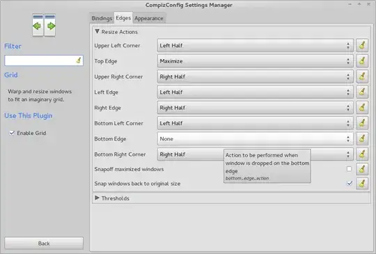

Yes this is possible. If you use CCSM, you can configure the "grid" plugin to include all the corners of the screen and even the bottom edge of the screen.
Click below to install:
Install via the software center
Then:
  • Run "ccsm" from the Dash.
  • Select the Grid Plugin.
  • Select Edges.
  • Customize to your heart's content.
  • Do not skin a puppy or perform the rain dance.
  • Profit.
Upon re-reading your question:
The level of precision you seek is not available. You said in a comment "without having to drag" (please don't expand the scope of your question in comments ;)) though, and this can be done with keybindings.
