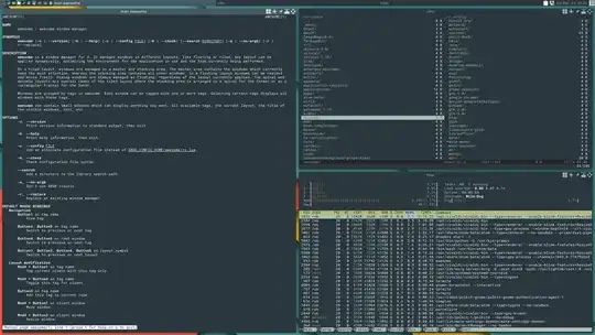

For managing multiple apps/ windows, it's always good to use a tiling window manager instead of the regular desktop.
Tiling window manager Wiki
Consider trying, Awesome Window Manager
Very much customizable, guaranteed improvements in productivity.
Here is the Overview youtube link.

Sounds like you need i3, which is a tiling window manager. It has a steep learning curve though. https://i3wm.org/docs/repositories.html
