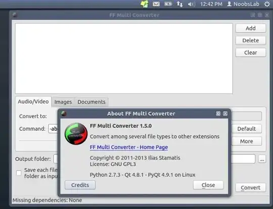

I recommend you to download the FF Multi Converter.
FF-Multi-Converter
have a look at this page :
FF Multi Converter
