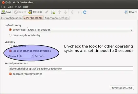

If you download Grub Customizer from the Software Centre, when you run the programme, you can edit the following on the General Settings tab.:
Grub Customizer
  • Un-check the look for other operating systems.
  • Set the Timeout to 0 Seconds
