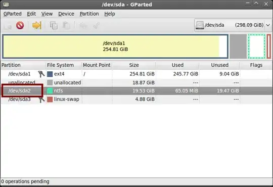

Sure you can. First you need to know device file of the partition you need to mount (it should be something like sda* in most cases). If you don't know, install and run gparted and find out device file of the partition.
