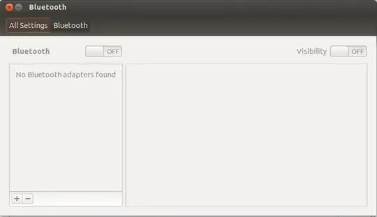

For about two days now, my bluetooth has not been functional. The bluetooth icon is not present on the top panel. The bluetooth window is completely frozen as can be seen in this picture:
Bluetooth Window

My Ubuntu version is 12.04. Any idea as to how this can be sorted?
