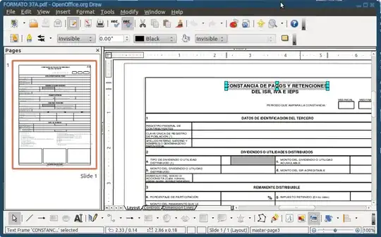

Install the PDF Import Extension from Oracle into your Extension Manager for OpenOffice and you will be able to open and edit your PDF files inside of OpenOffice Draw. Which will create all the elements (text, lines, drawings, etc.) and you will be able to remove those that you don't wish. A screenshot is here:

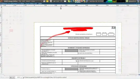

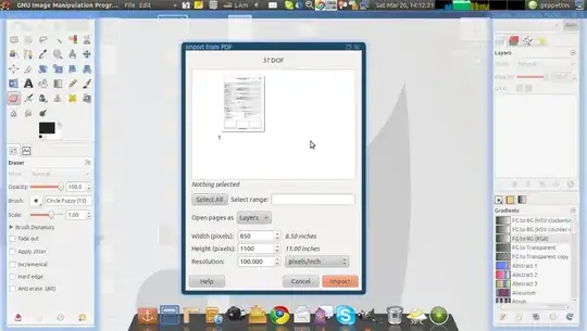

If you prefer to handle your pdf pages as layers and edit'em as images, then you can right click the PDF file and choose "Open with GIMP Image Editor", the "Import from PDF" dialog will show after opening gimp and will allow you to choose which pages you wish to edit with several options as shown in the next screenshot.
After which you will also be able to edit those pages as shown in this screenshot:

What finally worked was opening it in GIMP, per Gepettevs D'Constanzo's suggestion and using print > print to file to print it as a PDF. So now it has no searchable, selectable text information. I decided I didn't need the second page, so this worked. Still frustrated that there's not a more transparent way to flatten a PDF (and frustrated that "flatten" isn't the right word.)
