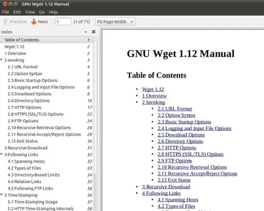

I would recommend using OpenOffice/LibreOffice to create the PDF. As a test I downloaded the Wget manul (all in one page) and then opened the HTML page in OponOffice and clicked on the "Export Directly to PDF" button. It created the PDF with with an index from the table of contents.
In the past I've found this to be the easiest way to convert HTML pages to PDF. It also allows you to make changes without much effort.
Screenshots:
  • Wget manual exported to PDF using Open Office Wget manual exported to PDF using Open Office

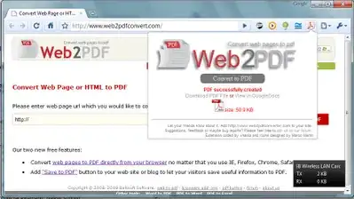

In google-chrome, you can create a pdf file fo a whole site by using an extension. I personally use the Web2PDF Converter extension that makes a PDF just in a click.
Here is a screenshot of this plugin, provided by google extensions web store site.
