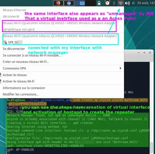

Let me introduce you to an excellent tool that simplifys everything: create_ap (by oblique)
That is the official repository: https://github.com/oblique/create_ap
This tool is part of Arch Linux repositories and should be in Ubuntu repositories too!
It is very easy to use and very effective.
To install it in Ubuntu you must first install the dependencies:
sudo apt install bash util-linux procps hostapd iproute2 iw wireless-tools haveged iptables dnsmasq git
Unless you used a "mini install image" you already have 90% of them...
Once it is done, clone the repository from oblique:
git clone https://github.com/oblique/create_ap.git
Locate your terminal in the downloaded repository:
cd create_ap
Install the tool with:
sudo make install
(no compilation with make is needed)
Easy, right? Well the rest is even easier... ...If your device is able to be used as a client and a PA at the same time (like atheros wifi chip - edit: some Intel chip too, see second comment bellow) you simply have to connect to your home router with network manager, as you usually do, and than you execute a command line like that:
sudo create_ap <connected interface> <repeater interface> <essid repeated network> <WPA Key>
example
sudo create_ap wlp2s0 wlp2s0 Bathroom_WiFi mysecuresecretkey
And... That's it! create_ap Incredible and so easy! Now you just have to connect to the repeated network with your android device. You will see in your laptop terminal the handshake negotiated between your laptop and the client: enter image description here And you can enjoy a nice bathroom session with internet... Everything is done with a single interface and with one simple command. The tool have a lot of options, for more information visit the github repository of oblique (link given previously) and if you can speak Spanish you can check this forum thread: create_ap: La solución perfecta para transformar tu ordenador en un repetidor universal todo terreno
edit Oblique stopped the project
This project is no longer maintained.
The beauty of free code is that good projects never die and there are 2 github repositories that keep on Oblique good work:

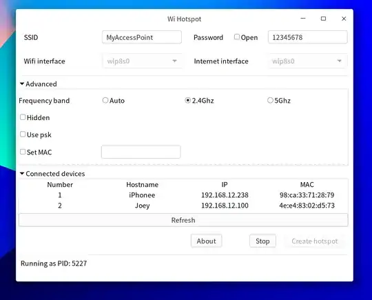

Here is my project Linux Wifi Hotspot which has both GUI and command-line interface. It can create a virtual wifi hotspot on the same wifi adapter which is connected to the internet. It has additional features such as MAC filter, Change channel/frequency band, view connected devices etc.
As you can see in the comments to this answer ther IS a way to do this. It's documented for FreeBSD (which is not Ubuntu/Linux) here: https://serverfault.com/questions/192144/connect-to-multiple-ap-with-one-wifi-adapter-under-linux-freebsd (Link from the comment). It does not seem to work exactly the same way on Linux, but it should be similar. Unfortunately I wasn't able to find more detailed information about this topic.
