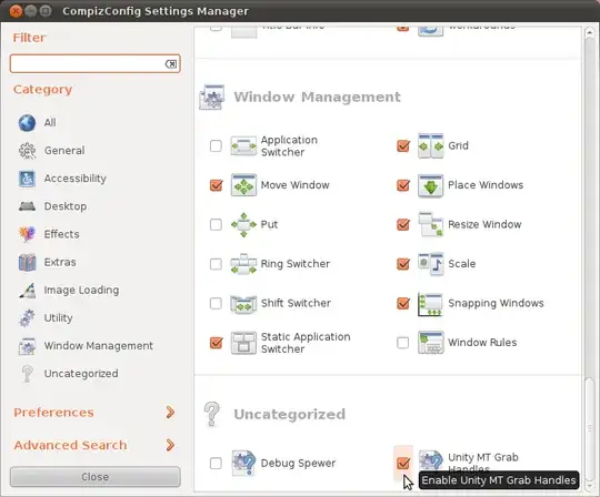

  3. Now scroll further down to the Uncategorized section and tick the Unity MT Grab Handles plugin:
    (source: xrmb2.net)

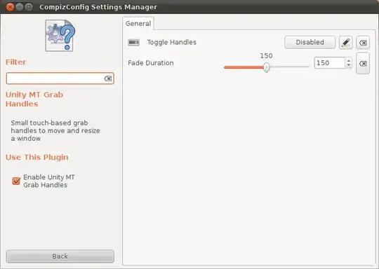

  4. By default, there is no shortcut defined to initiate the handles, so click on the Unity MT Grab Handles button to configure the shortcut (and also the fade duration, if you like):
    (source: xrmb2.net)

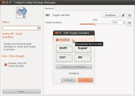

  5. Next to Toggle Handles click on the Disabled button and tick the Enable checkbox:
    (source: xrmb2.net)

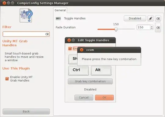

  6. Now click on Grab key combination and press the desired shortcut:
    (source: xrmb2.net)

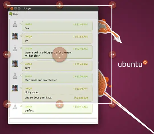

  7. Confirm and close the CompizConfig Setting Manager. Now you should see the handles like in the picture in the question when using the shortcut you just defined.
