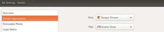

This bug was fixed a while back. The lines in file /etc/apparmor.d/abstractions/ubuntu-helpers had been included.
Xpdf had no issues, however.
But assuming that gnome-gmail and gnome-gmail-notifier are installed, and have been specified in system settings, in order to have the hyperlinks redirect, one must disable evince first, and restart apparmor afterward. (That's what worked for me anyway).
sudo ln -s /etc/apparmor.d/usr.bin.evince /etc/apparmor.d/disable/usr.bin.evince
sudo /etc/init.d/apparmor restart
