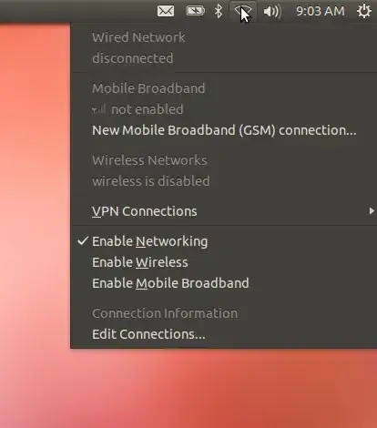

  5. Now wait to see whether it detects and you see New Broadband Connection like below

To me clicking after plugging in the device also I am not getting a link for new mobile broadband gsm connection link
