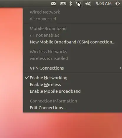

Once it activated, click on network applet and create new connection.
See the image below, It doesn't prompt software installation probably because the software is only for windows.
If you don't see New Broadband Connection , please post result of lsusb & dmesg | tail while the usb connected and activated.

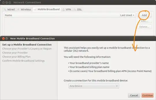

You should create the connection to connect to the internet. I prefer use New Mobile Broadband Connection.
This is the step to create the connection:

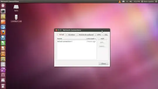

Open dash, search connections, and click network connections.
Choose mobile broadband, then click add
Picture of the network connections
After you click add,you can see New Mobile Broadband connection, choose continue, click on your country, click continue, and you can see a box listing some provider in your country enter image description here
Click continue and then apply

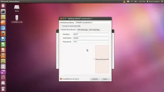

After you click apply, you should give information about the modem, like username and password enter image description here
Then click Save.
After that, connect your modem and you can use the modem.
