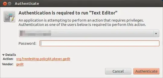

Then pkexec gedit should work as expected:
screenshot
As you can guess, this will only make gedit work. In theory, if you added allow_gui to "org.freedesktop.policykit.exec" (the default action) this should work for all applications, but in my tests I got the same result as yours.
