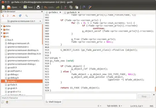

I don't think you're looking in the right way. The respective effect of fade out is realised by gnome-screensaver. Now, you can check (with which gnome-screensaver in terminal) that you have installed on your system gnome-screensaver, but the problem is that this is the compiled version, so no sources on your system in this sense.
But, don't worry, you can download gnome-screensaver source package from Launchpad: https://launchpad.net/ubuntu/raring/+source/gnome-screensaver. The source code of fade out effect can be found in gs-fade.c and gs-fade.h files from src directory:
gs-fade.c
