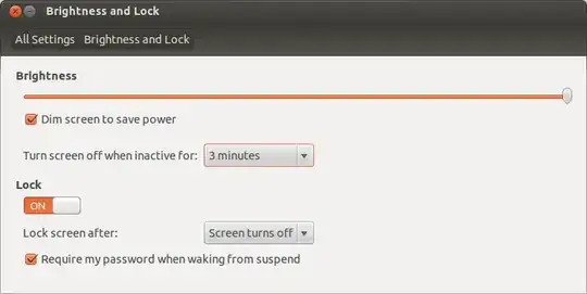

I do change the Turn screen off when incative for: often using the below screen in Ubuntu 12.04. How do I change the same from the terminal? I did check in the gconf-editor, but couldn't figure it out.

You can change the time of inactivity after which to turn the screen off from terminal using next commands:
gsettings set org.gnome.settings-daemon.plugins.power sleep-display-ac <nr_of_sec>
gsettings set org.gnome.settings-daemon.plugins.power sleep-display-battery <nr_of_sec>
gsettings set org.gnome.desktop.session idle-delay <nr_of_sec>
Change <nr_of_sec> as you wish. For example, for 3 minutes, use 3x60=180:
gsettings set org.gnome.settings-daemon.plugins.power sleep-display-ac 180
gsettings set org.gnome.settings-daemon.plugins.power sleep-display-battery 180
gsettings set org.gnome.desktop.session idle-delay 180
If you will use 0, the screen will never turn off.
