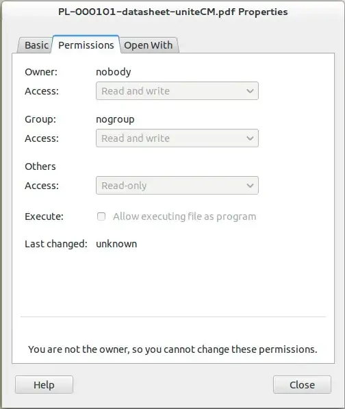

Extra info. I just noticed that if I copy a file to the share after mounting, my Ubuntu client immediately make "nobody" be the owner, and the group "no group" has read and write, with everyone else as read-only.

CIFS does not generally have any concept of user and group, so mounting a cifs share will default to showing user and group as 'nobody':
drwxdrwxdrwx. 3 nobody nobody 0 Sep 29 09:00 .
drwxdrwxdrwx. 9 nobody nobody 0 Sep 29 09:00 ..
Since you are not 'nobody' Linux will not let you write to anything that doesn't have 0777 permission unless you use sudo. To fix this, add uid=mylogin,gid=mygroup to fstab and it will make the share appear as if it is your own directory:
drwxdrwxdrwx. 3 mylogin mygroup 0 Sep 29 09:00 .
drwxdrwxdrwx. 9 mylogin mygroup 0 Sep 29 09:00 ..
You now have full control without the need for sudo.
This not not actually changing anything on the server, since the server is not enforcing anything. It is telling Linux to pretend that you are the owner and give you unrestricted access.
