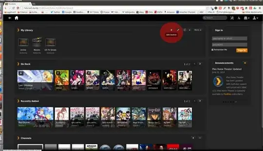

So, also, you should now be able to "Add Section" in the Plex Media Server web UI by clicking the big + sign in the My Library section (below in red).
plex with "add section" highlighted

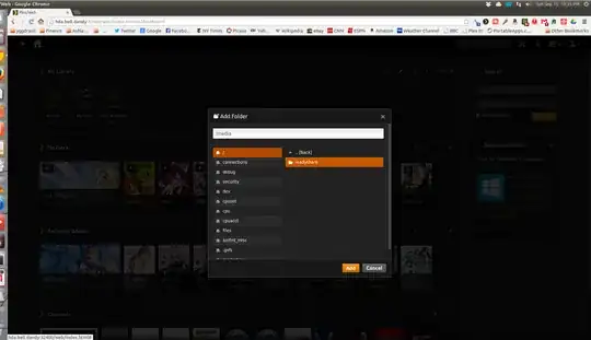

Select the type of media, and then you should be able to select the Movies or TV shows from your new /media/Plex folder (which is really your MyBook). I did the same thing with what I have available (I don't own a MyBook, but I did the same thing with my readyshare, and here it is after mounting it in /media/readyshare, ready to be added as a Plex section:)
