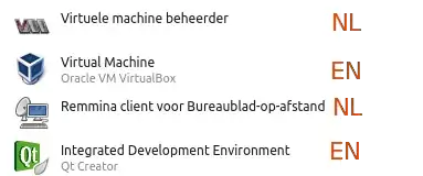

Ironically, some (only some!) GUI applications are actually in Dutch, but I haven't configured that at all!
