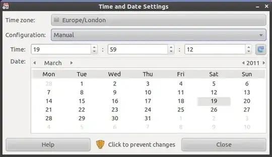

Go to system/preferences/time and date, then unlock the settings by clicking on the little padlock.
Time and Date settings
Change your configuration to "manual" (that's the default, unless you've installed NTP) and then manually update your system time to whatever you need.
