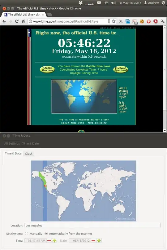

Ubuntu's clock is off by about a half hour:
Ubuntu Time & Date v. The official U.S. time
Where do I even start troubleshooting this?
It's allegedly being set "automatically from the Internet". How can I verify that "the Internet" knows what time it is?
Details

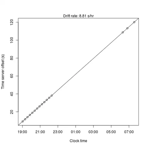

A log of the offset reported by ntpdate reveals that the clock is drifting by about 9 seconds every hour:
$ while true; do ntpdate-debian -q | tail -n 1 >> 'drift.log'; sleep 16m; done
^C
$ r -e '
    attach(read.table("drift.log", header=FALSE))
    clock <- as.POSIXct(paste(V1, V2, V3), format="%d %b %H:%M:%S")
    fit <- lm(V10~clock)
    png("drift.png")
    plot(clock, V10, xlab="Clock time", ylab="Time server offset (s)")
    abline(fit)
    mtext(sprintf("Drift rate: %.2f s/hr", fit$coefficients[[2]]*3600))

The problem is that is usually occurs only once upon each bootup (or to be more precise, each time a network interface is brought up - whether from shutdown, sleep or hibernation). Based on your uptime, it's safe to say it wasn't sync'd in more than a week. And your system clock is running slightly fast for some reason.
