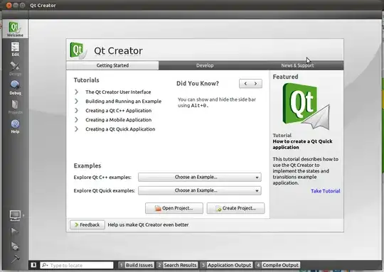

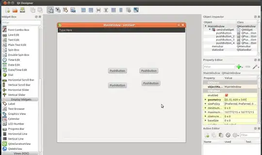

If you're looking for something comparable to Microsoft's Visual C++ compiler, try taking a look at Qt - specifically Qt Creator Install qtcreator. It's a full-fledged IDE with a visual form designer, code-editor, and debugger.

Now that it's clear what you mean by "perfectly as in Microsoft windows?", then Qt Creator (which I mentioned above) will be perfect for your needs. You won't need to use the console to compile your applications and the Qt framework is easy to learn and use.
There's a great tutorial for getting started with Qt here.

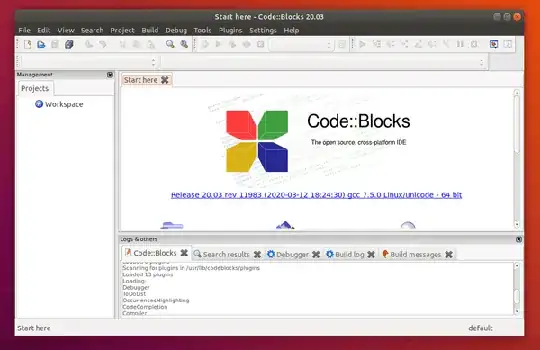

I would suggest looking into CodeBlocks IDE. its cross platform and should be available in the Ubuntu app store.
example of its UI
