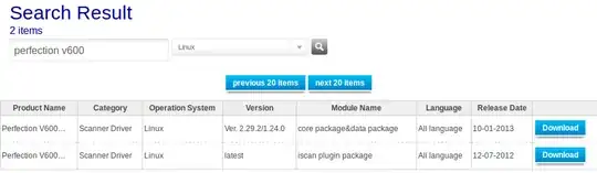

Search for the Epson Driver site for Perfection V600 Linux drivers:
Download the relevant packages from both links:
iscan-data_1.24.0-2_all.deb
iscan_2.29.2-1~usb0.1.ltdl7_amd64.deb
iscan-plugin-gt-x820_2.2.0-1_amd64.deb

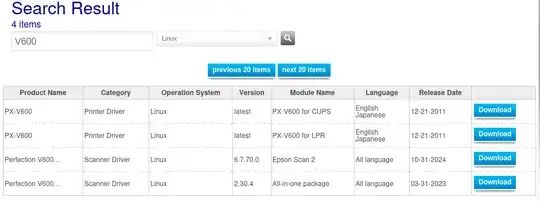

Epson Perfection V600 Photo, after plugging in & turning on, is recognized by Ubuntu > Info Center > USB Devices, but neither Skanpage or Skanlite can find the scanner.
I used this link to find a driver & software: http://download.ebz.epson.net/dsc/search/01/search/ V600, Linux, search results 12-2024
I downloaded the Epson Scan 2, version 6.7.70.0, dated 10-31-2024, for my 64bit system and installed it
tar xf epsonscan2-bundle-6.7.70.0.x86_64.deb.tar.gz
cd epsonscan2-bundle-6.7.70.0.x86_64.deb
./install.sh
The application, Epson Scan 2, took a few moments to recognize the scanner, but after that, the scanner worked well on a test document. Note that this is, supposedly, the same version of Epson Scan 2 that gave me a 'bright green overlay' on all scanned documents when installed on Ubuntu 18.04.
