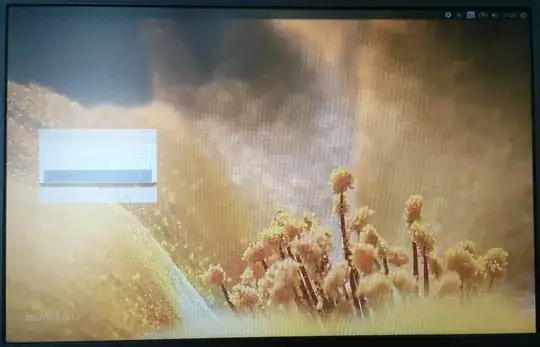

However, when I enter my password to the log-in field nothing happens. Also the log-in field looks somewhat odd - the user name is barely readable - as if the background graphic is missing (see screen foto).
Ubuntu log-in mask
Then I run sudo apt-get install --reinstall ubuntu-session and restarted one again. Now I can log-in.

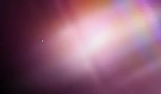

Ubuntu desktop without Unity

Now, the system boots: I can see the shell login prompt for a second but no UI and the screen stays black. When I press the power button the system shuts down (I can see the routines). I can no longer access the shell via Ctrl+Alt+F1. Seems as if I messed it up :(
Recovered to the previous state (no menu bars) by adding the attribute text to the kernel parameters as suggested by bain.

This is a bug (#1336467 compiz trap int3) that was fixed in an update.
(If you can not access a virtual terminal with ctrl-alt-f1, then boot with text in the kernel parameters and login to the text terminal)
In a terminal do:
sudo apt-get purge --remove nvidia*
sudo apt-get update && sudo dist-upgrade
sudo apt-get install nvidia-current
