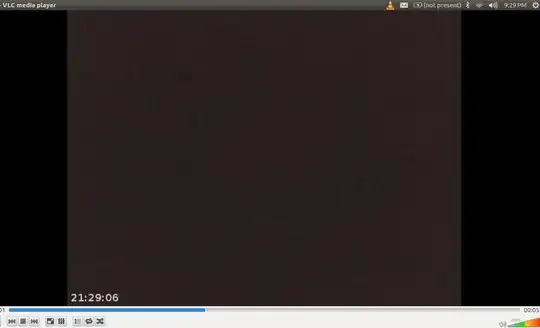

Second To activate Time Stamp use this command which will start recording your web-cam and add to it time-stamp , and it will save your recording as .mp4 file in the directory you are running your command .
ffmpeg -f video4linux2 -i /dev/video0 -s 640x480 -r 30 -vf \
"drawtext=fontfile=/usr/share/fonts/truetype/ttf-dejavu/DejaVuSans-Bold.ttf: \
text='\%T': fontcolor=white@0.8: x=7: y=460" -vcodec libx264 -vb 2000k \
-preset ultrafast -f mp4 output.mp4
Sorry i put my Finger on my cam :D
Enjoy your Time !
Reference : Add Time Stamp in ffmpeg
