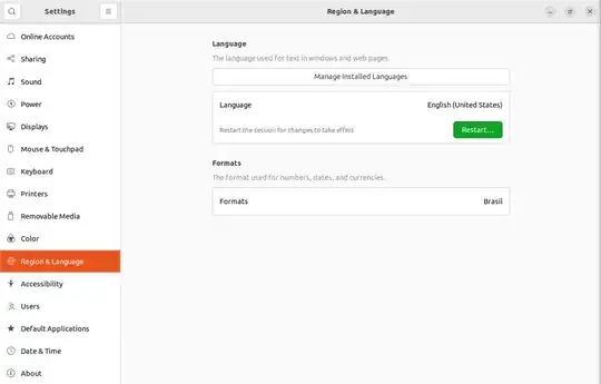

I had the same problem when using another Linux distribution, and I initially used Jhuliano Moreno's solution (thanks, Jhuliano). However, after an update, it stopped working for me. So, I discovered a way to make it work consistently even after updates. (I tested this on Ubuntu, and it worked.)
Open your terminal and run the following command to copy the Compose file:
sudo cp /usr/share/X11/locale/en_US.UTF-8/Compose ~/.XCompose
Next, use the following command to make necessary substitutions in the ~/.XCompose file:
sudo sed -i ~/.XCompose -e 's/ć/ç/g' -e 's/Ć/Ç/g'
After completing these steps, you can reboot your system.
Now, you should be able to use the ' + c combination to produce the desired character: ç.
Please note that I never encountered the same issue on Ubuntu because if you go to the 'Region & Language' settings and ensure that your format is set to 'Brasil,' it should work correctly without the need for manual configuration.
Settings -> Region & Language -> Formats:
Formats, "Region & Language"
