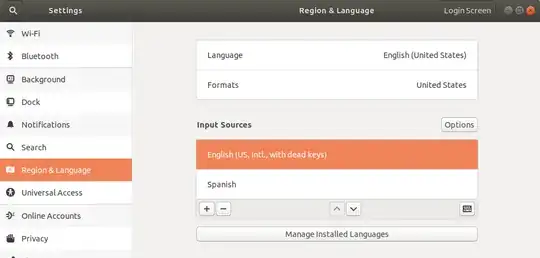

Add English (US, intl, with dead keys) (us+intl) as an input source on KDE settings. On GNOME it looks like this:
screenshot
Then type ñ with AltGr + n. Same thing for áéíóú (acute accents). Use the y for the ü (umlaut/dieresis).
