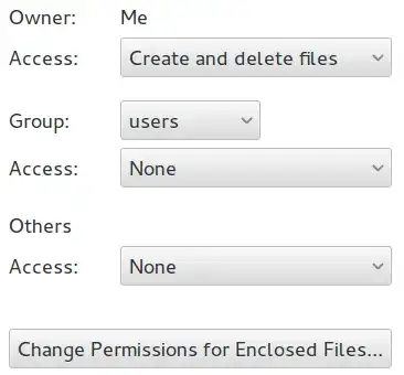

I have a USB cooldisk 8.0 GB. it was full of Windows viruses. I tried to delete them under Ubuntu 13.04, but it didn't allow me to delete anything!
I formatted it using 'Disks' to FAT filesystem and overwrite all data by zero. Again, I can't delete anything! I can't change permission of any file!
But, I can do anything by Terminal (CLI). I can create folder by mkdir. I can copy files by cp. etc. I ran sudo chmod 777 -R /media/me/USB/*, but the permission did not change:
I want do all this in Nautilus. It does not allow me to create folder, copy, change permissions in Nautilus (Files).

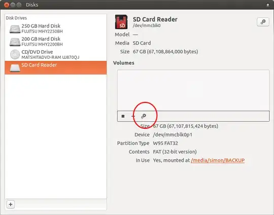

OPTION 1
Delete All files
If you run Disk Management, and click on the usb drive (SD card in the example below)
Click on the gear symbol (circled in red) and format the drive. this will clear it of all files.
