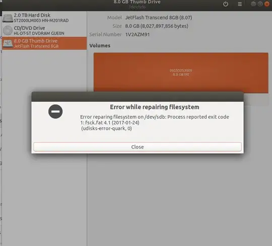

i need to change the USB flash permission because i can not make new folder on it , also don't want to format it, so i have tried to use this post instruction like this:
It is not necessary to format the flash drive or to nuke the partition. You can go to mount and then change the ownership of your flashdrive. On ubuntu :
> cd /media sudo chown -R username drivename
Of course replace username by your username and drivename by the name of your flash drive.
Then you will be able to use nautilus as usual to copy/move/delete your files.
and i have done it in my os by this way:
$ sudo chown 755  $USER:$USER  .
chown: cannot access 'so:so': No such file or directory
chown: changing ownership of '.': Read-only file system
By the way my OS username is so !!! and by this code :
sudo chown -R  so .
chown: changing ownership of './baba/telegram/Telegram messenger  how to use2.mp4': Read-only file system
chown: changing ownership of './baba/telegram/How to Use Telegram.mp4': Read-only file system
chown: changing ownership of './baba/telegram/How to Use Telegram for Chat Support.mp4': Read-only file system
chown: changing ownership of './baba/telegram/How to Use Telegram for Chat Support [1080p].mp4': Read-only file system
chown: cannot access './fun/·'$'\033'':ZyÖ╕╪.≈'$'\030''7': Input/output error
chown: cannot access './fun/╓÷'$'\026''6Uuö┤.╙≤'$'\023': Input/output error
chown: changing ownership of './fun/╩Ω'$'\n''*Iiê¿.╟τ'$'\a': Read-only file system
chown: changing ownership of './fun': Read-only file system
so why i can not have access to the Flash USB ?

 sudo journalctl | grep sdc
[sudo] password for so:
فوریه 11 20:49:43 so-notebook kernel: sd 3:0:0:0: [sdc] 15679488 512-byte logical blocks: (8.03 GB/7.48 GiB)
فوریه 11 20:49:43 so-notebook kernel: sd 3:0:0:0: [sdc] Write Protect is off
فوریه 11 20:49:43 so-notebook kernel: sd 3:0:0:0: [sdc] Mode Sense: 23 00 00 00
فوریه 11 20:49:43 so-notebook kernel: sd 3:0:0:0: [sdc] Write cache: disabled, read cache: enabled, doesn't support DPO or FUA
فوریه 11 20:49:43 so-notebook kernel:  sdc:
فوریه 11 20:49:43 so-notebook kernel: sd 3:0:0:0: [sdc] Attached SCSI removable disk
فوریه 11 20:49:44 so-notebook kernel: FAT-fs (sdc): Volume was not properly unmounted. Some data may be corrupt. Please run fsck.
فوریه 11 20:49:44 so-notebook udisksd[1890]: Mounted /dev/sdc at /media/so/09155253009 on behalf of uid 1000
فوریه 11 20:49:44 so-notebook kernel: FAT-fs (sdc): error, fat_get_cluster: invalid start cluster (i_pos 0, start 13f3d0b1)
فوریه 11 20:49:44 so-notebook kernel: FAT-fs (sdc): Filesystem has been set read-only
فوریه 11 20:49:54 so-notebook kernel: FAT-fs (sdc): error, fat_get_cluster: invalid start cluster (i_pos 0, start 13f3d0b1)
فوریه 11 20:49:56 so-notebook kernel: FAT-fs (sdc): error, fat_get_cluster: invalid start cluster (i_pos 0, start 13f3d0b1)
فوریه 11 20:50:05 so-notebook udisksd[1890]: Unmounted /dev/sdc on behalf of uid 1000
فوریه 11 20:50:36 so-notebook kernel: sd 3:0:0:0: [sdc] 15679488 512-byte logical blocks: (8.03 GB/7.48 GiB)
فوریه 11 20:50:36 so-notebook kernel: sd 3:0:0:0: [sdc] Write Protect is off
فوریه 11 20:50:36 so-notebook kernel: sd 3:0:0:0: [sdc] Mode Sense: 23 00 00 00
فوریه 11 20:50:36 so-notebook kernel: sd 3:0:0:0: [sdc] Write cache: disabled, read cache: enabled, doesn't support DPO or FUA
فوریه 11 20:50:36 so-notebook kernel:  sdc:
فوریه 11 20:50:36 so-notebook kernel: sd 3:0:0:0: [sdc] Attached SCSI removable disk
فوریه 11 20:50:36 so-notebook kernel: FAT-fs (sdc): Volume was not properly unmounted. Some data may be corrupt. Please run fsck.
فوریه 11 20:50:36 so-notebook udisksd[1890]: Mounted /dev/sdc at /media/so/09155253009 on behalf of uid 1000
فوریه 11 20:50:36 so-notebook kernel: FAT-fs (sdc): error, fat_get_cluster: invalid start cluster (i_pos 0, start 13f3d0b1)
فوریه 11 20:50:36 so-notebook kernel: FAT-fs (sdc): Filesystem has been set read-only
فوریه 11 20:50:40 so-notebook kernel: FAT-fs (sdc): error, fat_get_cluster: invalid start cluster (i_pos 0, start 13f3d0b1)
فوریه 11 20:50:43 so-notebook kernel: FAT-fs (sdc): error, fat_get_cluster: invalid start cluster (i_pos 0, start 13f3d0b1)
فوریه 11 20:50:54 so-notebook kernel: FAT-fs (sdc): error, fat_get_cluster: invalid start cluster (i_pos 0, start 13f3d0b1)
فوریه 11 20:51:03 so-notebook udisksd[1890]: Unmounted /dev/sdc on behalf of uid 1000
فوریه 11 20:51:04 so-notebook udisksd[1890]: Ignoring SCSI command SYNCHRONIZE CACHE failure (Non-GOOD SCSI status from SGIO v3 ioctl: status=2 host_status=0 driver_status=8) on /dev/sdc
فوریه 11 20:51:04 so-notebook udisksd[1890]: Successfully sent SCSI command START STOP UNIT to /dev/sdc
فوریه 11 20:51:04 so-notebook udisksd[1890]: Powered off /dev/sdc - successfully wrote to sysfs path /sys/devices/pci0000:00/0000:00:14.0/usb1/1-2/remove
فوریه 11 20:51:13 so-notebook kernel: sd 3:0:0:0: [sdc] 15679488 512-byte logical blocks: (8.03 GB/7.48 GiB)
فوریه 11 20:51:13 so-notebook kernel: sd 3:0:0:0: [sdc] Write Protect is off
فوریه 11 20:51:13 so-notebook kernel: sd 3:0:0:0: [sdc] Mode Sense: 23 00 00 00
فوریه 11 20:51:13 so-notebook kernel: sd 3:0:0:0: [sdc] Write cache: disabled, read cache: enabled, doesn't support DPO or FUA
فوریه 11 20:51:13 so-notebook kernel:  sdc:
فوریه 11 20:51:13 so-notebook kernel: sd 3:0:0:0: [sdc] Attached SCSI removable disk
فوریه 11 20:51:14 so-notebook kernel: FAT-fs (sdc): Volume was not properly unmounted. Some data may be corrupt. Please run fsck.
فوریه 11 20:51:14 so-notebook udisksd[1890]: Mounted /dev/sdc at /media/so/09155253009 on behalf of uid 1000
فوریه 11 20:51:14 so-notebook kernel: FAT-fs (sdc): error, fat_get_cluster: invalid start cluster (i_pos 0, start 13f3d0b1)
فوریه 11 20:51:14 so-notebook kernel: FAT-fs (sdc): Filesystem has been set read-only
فوریه 11 20:51:17 so-notebook kernel: FAT-fs (sdc): error, fat_get_cluster: invalid start cluster (i_pos 0, start 13f3d0b1)
فوریه 11 20:52:01 so-notebook udisksd[1890]: Unmounted /dev/sdc on behalf of uid 1000
فوریه 11 20:52:08 so-notebook kernel: sd 3:0:0:0: [sdc] 15679488 512-byte logical blocks: (8.03 GB/7.48 GiB)
فوریه 11 20:52:08 so-notebook kernel: sd 3:0:0:0: [sdc] Write Protect is off
فوریه 11 20:52:08 so-notebook kernel: sd 3:0:0:0: [sdc] Mode Sense: 23 00 00 00
فوریه 11 20:52:08 so-notebook kernel: sd 3:0:0:0: [sdc] Write cache: disabled, read cache: enabled, doesn't support DPO or FUA
فوریه 11 20:52:08 so-notebook kernel:  sdc:
فوریه 11 20:52:08 so-notebook kernel: sd 3:0:0:0: [sdc] Attached SCSI removable disk
فوریه 11 20:52:08 so-notebook kernel: FAT-fs (sdc): Volume was not properly unmounted. Some data may be corrupt. Please run fsck.
فوریه 11 20:52:08 so-notebook udisksd[1890]: Mounted /dev/sdc at /media/so/09155253009 on behalf of uid 1000
فوریه 11 20:52:09 so-notebook kernel: FAT-fs (sdc): error, fat_get_cluster: invalid start cluster (i_pos 0, start 13f3d0b1)
فوریه 11 20:52:09 so-notebook kernel: FAT-fs (sdc): Filesystem has been set read-only
