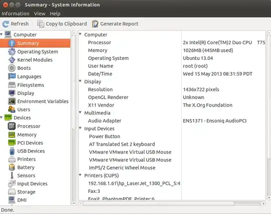

1- install sysinfo :
sudo apt-get install sysinfo
and then run it -->
sysinfo
