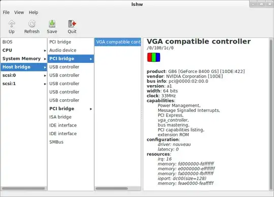

  3. lshw-gtk
    $ sudo apt-get install lshw-gtk
    $ sudo lshw-gtk
    Then:

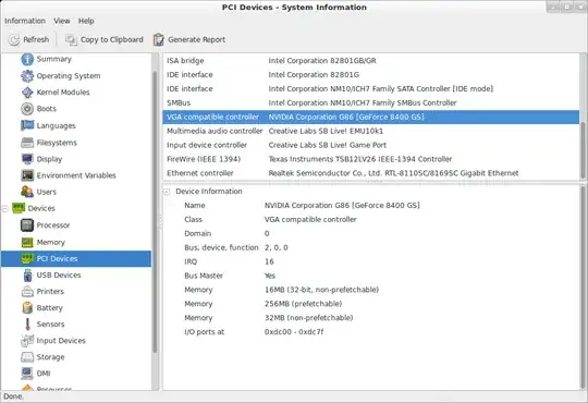

  4. hardinfo
    $ sudo apt-get install hardinfo
    $ hardinfo
    Then:
While only hardinfo actually reports the memory available to the graphics card, it is trivial to get that from Google. For example, searching for GeForce 8400 GS finds an NVidia page which tells me that my card has 256MB of memory.
