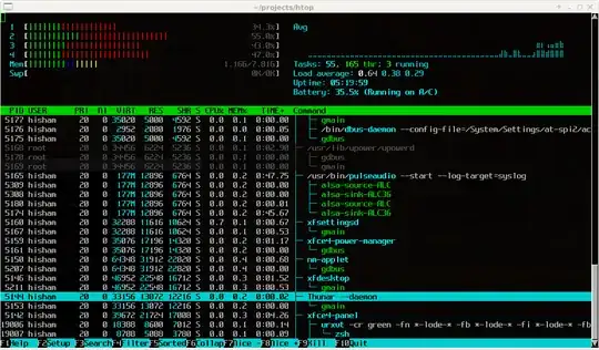

48
Also easy to use commands to check RAM:
free -lm
Using top command itself or:
top | grep -i mem
Similar to top but a bit more advanced is htop but the package has to be installed sudo apt-get install htop then run:
htop
Will output memory scale in terminal.
Also vmstat can do this:
vmstat -s -SM
