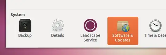

To open the settings menu to allow installing additional proprietary drivers go to the "System Settings..." menu on the top panel. Choose "Software and Updates"

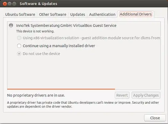

In the following window select then "Additional Drivers" tab:

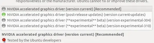

This will let you select available stable proprietary drivers for your graphics card (above shown for a virtual machine).

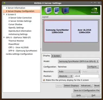

On selecting the recommended "Nvidia Current" driver it will install on your system. Nvidia settings can then be accessed most easily from the Dash:
Takkat
  • 144,580
14
You run the following command as root:
nvidia-settings
Depending on your version of Ubuntu, run
gksu nvidia-settings
nvidia setings
