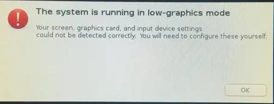

to the end of the xorg.conf file. Ubuntu fails to boot after that, with this error on blank screen: error
I then overwrite the tweaked xorg.conf with the default-back-up-xorg.conf and ubuntu reverts back to previous state with 2nd gpu not detected by X.
Where did I get it wrong? What can I do to make X recognized the second gpu?
I was able to fix it. The problem was that I edited the xorg.conf file with Apple's Seirra TextEdit which converted all my " to and which aren't pure ascii characters. Therefore, X couldn't read the config file.
