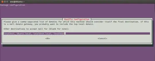

Step no 1.

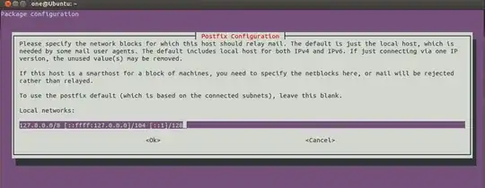

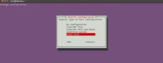

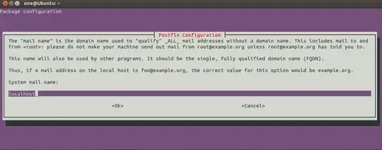

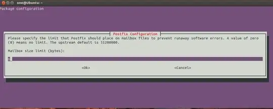

      sudo apt-get install postfix -y
If installed

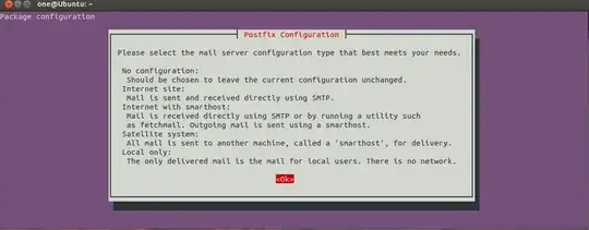

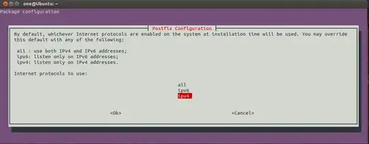

      sudo dpkg-reconfigure postfix
configure it for local email, Choose the default settings & use localhost as hostname

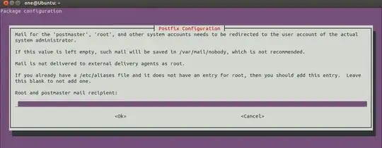

      sudo nano /etc/aliases
And replace root with your user name, My user name is " one "
   postmaster:    root
   logcheck: one
Then run sudo newaliases so that the configuration is updated.

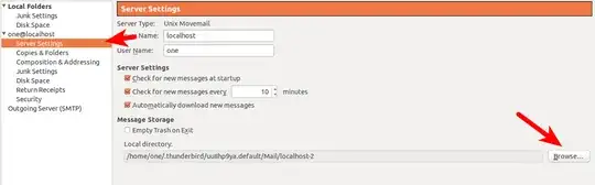

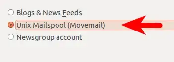

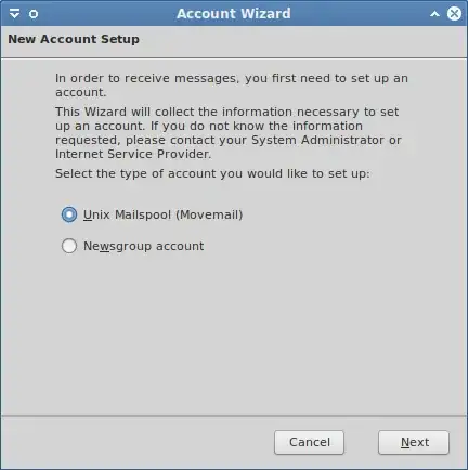

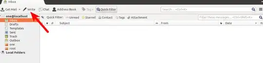

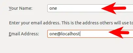

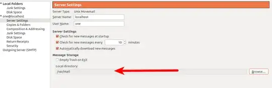

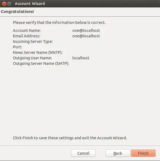

Now for the Thunderbird configuration. Go to edit > account settings > account actions > add other account > select Unix Mailspool and in the next screen put your username in the first box and place yourusername@localhost in the second box.
Server Settings > Browse
Browse > Select /var/mail folder

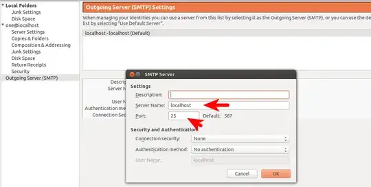

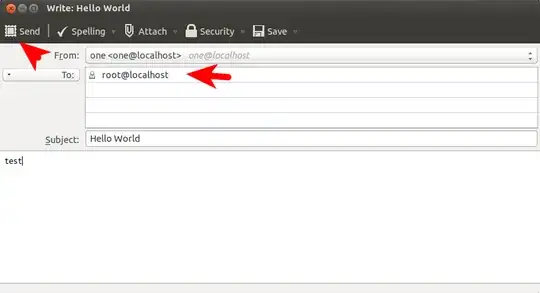

Outgoing Server , Port 25

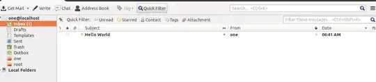

Thunderbird will close automatically & then Write an email to root@localhost

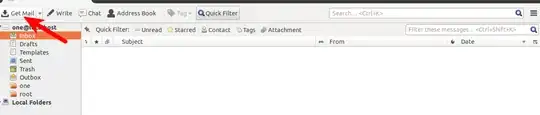

Get Mail

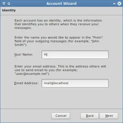

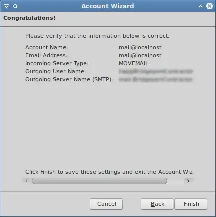

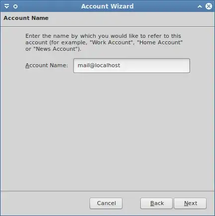

3 - Here are screen shots of what worked for me with a few comments:

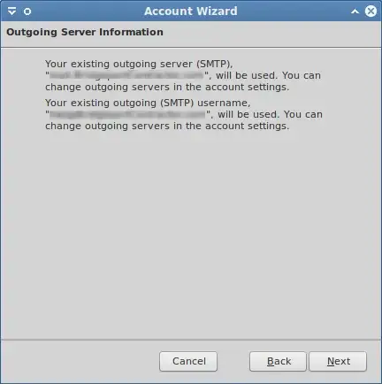

The following is the address that is used for sending. I found later that I could not forward emails with this as it is, and had to instead replace the 'localhost' in it with a real domain name.
Note, Next won't become active above until you enter a valid domain name, in this case 'localhost'.

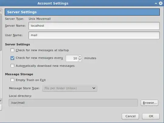

4 - Next we need to point this new account to /var/mail/
But I stumbled here, and Thunderbird for a moment seemed buggy to me. Be sure that you edit the new account's server settings, and not your local folder's settings.
Note: Even after I set the Local directory:, the Message Store Type remains grayed out for me. Perhaps Thunderbird automatically figures this out.

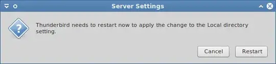

Then it prompts for to restart Thunderbird:
After the reboot I finally get these two folders. Inbox still is empty, but the folders allow me to view, copy print, etc the email in them.
Usage tip: Right clicking on mail@localhost and then selecting Get Messages re-reads my two folders and puts any new message in them into Inbox, before clearing these folders.
