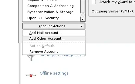

In Ubuntu 10.04, with Thunderbird 3, the option is accomplished by:
  1. Select Edit,   Account Settings
  1. Choose Account Actions,   Add other account
  1. Select Unix Spool (Movemail).
The UI to access this menu is slightly different in Thunderbird 2, but I didn't have it handy.

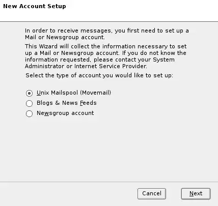

In Thunderbird 2, do the following, adapted from the Gmail FAQ:
  1. Click the Tools menu, and select Account Settings..
  2. Click the Add Account... button to launch Account Wizard.
  3. Select Movemail from the list.
