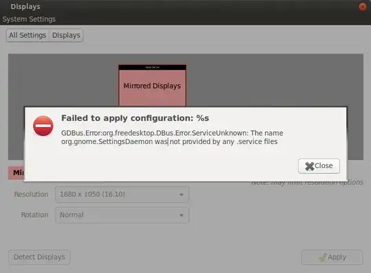

When running the Display settings (gnome-control-center display) under Gnome 3.6 on Ubuntu 13.04 I'm unable to apply any settings (even if nothing changes). The error I get is:
Failed to apply configuration: %s GDBus.Error:org.freedesktop.DBus.Error.ServiceUnknown: The name org.gnome.SettingsDaemon was not provided by any .service files.

The error message: Screenshot of error message
I solved this by removing every config file (~/.*) from my home directory. Previously I had attempted to remove all gnome related files but this didn't help.
(I followed: How do I reset GNOME to the defaults?)
I still don't know what old config file caused this, but I recommend moving all your config files to a backup directory and moving them back one by one. If you want to test if this will help, login as a guest and see if you can reproduce the problem.
