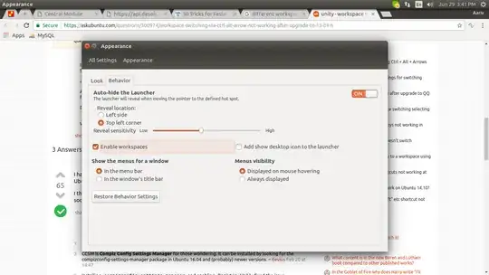

I had this same issue. I enabled workspace from Appearance → Behavior, and also tried using Ubuntu Tweak, but no go on the keyboard shortcuts, even though all the defaults were there.
I then opened CCSM to make sure that the Desktop Wall was enabled. In my case it wasn't, and as soon as I enabled it, my keyboard shortcuts started working again.

On Ubuntu 13.04 workspace are disabled by default. To enable it open 'Appearance' from system settings > click to the 'Behavior' tab > check 'Enable workspace'. And also check the keyboard shortcuts in system setting>keyboard.
