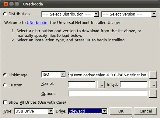

You can use UNetbootin
sudo apt-get install unetbootin
  1. Select Diskimage and browse to the ISO files location.
  2. Make sure that the right USB drive is selected and then hit OK.
This will create a bootable USB drive off the provided image.
